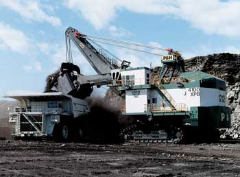

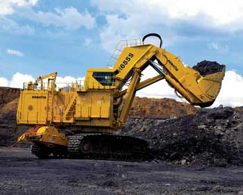

Since the time of the California gold rush, North Americans have seen tremendous changes in the surface mining industry. Mining equipment has evolved into some of the most fascinating functional mechanical structures known to man.
From its beginning, mining tools have evolved into massive machines. Greatly increased component sizes and load limits have placed tremendous responsibility on the machinery designer and the lubricant system manufacturer to design and engineer systems that can be counted on to effectively lubricate and sustain these machines.
These machines are often as large as houses, with some booms extending nearly 300 feet. As the machines have grown in size and sophistication, the manufacturers of high quality, high-temperature lubrication products and delivery systems have had to work equally hard to match the new requirements As one might expect, effective lubrication of these heavily loaded components is critical to the efficient, reliable, economical operation of a mine site.

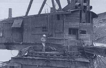

Lubrication distribution systems have improved greatly over the years, especially when you consider what would have been used on the Bucyrus 24 dragline in the early 1900s. The lower funnel-shaped half of the unit would be threaded into a port in the bearing housing. The upper cylinder-shaped half would be full of multipurpose grease (MPG).
Turning the upper cylinder clockwise would lower the cylinder onto the funnel-shaped portion, forcing (extruding) the lubricant stored in the reservoir of the cylinder portion through the funnel into the bearing.
The lube tech would make routine lubrication checks throughout the machine. As required, these lubricators would be turned to ensure the lubricated components received adequate replenishment while in use.

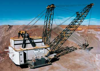

Walking draglines may require lubricants for the very large plain bearings that support the entire frame of the unit as it moves through the walking process.
These lubricants may have a high concentration of lubricating solids or soft metals dispersed into a stiff grease and delivered in small bags (for the walking mechanism without an automatic delivery system) just ahead of the peak loading area. This grease is referred to as a Walking Cam lubricant.
An effort to reduce the number of lubricants on a machine has driven the development of multipurpose, wide-temperature-operating greases designed to meet several different applications from a single lubrication system. The various components to be lubricated may include the open gears, guide rails, main table bearings, and various smaller slides and bearings.
