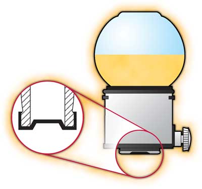

One such constant level oiler is the glass Opto-Matic® made by Trico Mfg. Corp. (Figure 2). This oiler consists of a glass reservoir mounted in a die cast collar which slides over a die cast base, or surge chamber. A beveled cap, attached to the bottom of the glass reservoir, ensures reliable oil delivery (Figure 3). It is at the surface of this cap that the level of oil is maintained, referred to as the control point, in both the oiler base and the equipment-housing sump. The cap/reservoir assembly sits on top of a level adjuster assembly that is inserted into the base, or surge chamber. Consistent oil sump level maintenance can be achieved by properly setting the adjuster assembly. Tightening the setscrew on the reservoir collar eliminates movement due to vibration and handling that can cause the oiler to feed more than needed.

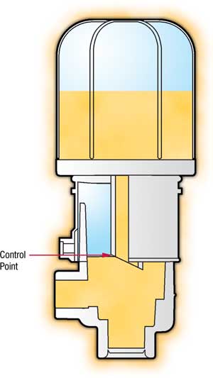

Other types of constant level oilers incorporate a tubular spout. This design differs from the glass reservoir/cap style by moving the level control point from the base of the reservoir to the spout opening (Figure 4). It is important to understand where the level is established in the constant level oiler in relation to the desired level in the housing oil sump. Depending on the oiler design, a simple mark on the base can effectively provide consistent level control.
Figure 3. Bevel on Oiler
Figure 4. Control Point on Spout
