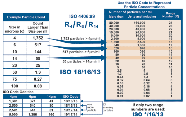

The International Organization for Standardization (ISO) has developed a code system called ISO Cleanliness codes, a universal standard for measuring and reporting particulate contamination levels in fluids. ISO 4406:99 is the newest and most commonly used cleanliness code. It is assigned on the basis of the number of particles per unit volume greater than 4, 6 and 14 microns. The numbers are given in this specific order for consistency in comparison. Each code represents a range of solid particles present in a lubricant.
What are ISO Cleanliness Codes?
First, particle count analysis is conducted on a representative sample of the fluid in a system. The particle count test provides the quantity and micron size of the various solid contaminants in the fluid. The actual particle count and subsequent ISO Cleanliness Code are compared to the target code for the system. If the actual cleanliness level of a system is worse than the desired target, corrective action is recommended.

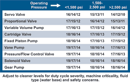

ISO Cleanliness codes themselves do not differ for various components. There are no set standards outside a handful of original equipment manufacturer recommendations, but Table 1 provides a fluid cleanliness guide for hydraulic systems.
Table 1. Typical Cleanliness Recommendations
Generally, the tighter the tolerance on the component’s metal-to-metal surfaces, the tighter the cleanliness code. For instance, servo valves on hydraulic systems are more susceptible to contamination-related failures than low-speed gearboxes. Therefore, the hydraulic reservoir fluid will require a lower ISO code (cleaner fluid) than the gearbox. This knowledge allows maintenance departments to focus on preventing failures instead of treating them, and prompts them to employ enhanced tactics to keep contamination out of the hydraulic reservoir.
