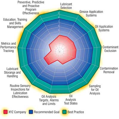

Roll out the OLE and other performance metrics in earnest during the deployment phase. These metrics serve as your barometer. If the OLE is going up, progress is being made. If the OLE trends downward, the cultural transformation didn’t fully take hold. The further it slides, the harder it will be to correct. Catch it early to avoid a salvage job. The objective is to reach and maintain the OLE goal, then begin to question the feasibility of even higher goals.
A good maintenance program also makes sense. This should include periodic benchmarking evaluations to uncover areas where the cultural transformation didn’t take hold, or to identify new opportunities that weren’t addressed in the original implementation plan. Also, because technology changes, it makes sense to reevaluate your program from time to time. The evaluation may look like the audit that caused you to seek change in the first place (see Figure 3).
Figure 3. Lubrication Benchmark Audit Diagram
