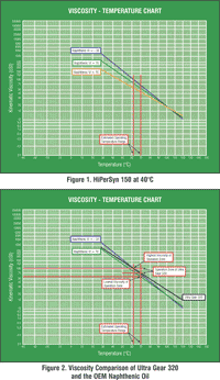

A viscosity index chart is used to compare the possible alternative lubricants to the originally specified lubricant. This chart enables the full viscosity profile of the lubricants to be observed and compared. It is an invaluable tool in comparing lubricants. To plot the viscosity profiles, two viscosities at two temperatures are needed.
This is available for both of the alternative lubricants, but for the original lubricant only one viscosity at 100°C has been given and the viscosity index has been estimated. ASTM D2270-04 will be used to calculate the viscosity of the naphthenic base oil at 40°C. Using formulas from ASTM D2270-04, the viscosity at 100°C of 18 cSt, and the viscosity index range of -30 to 70, it was calculated that the viscosity at 40°C would have been 260 cSt to 472 cSt, respectively.

HiPerSyn 150 is a synthetic that would provide better oxidation stability. At 100°C, both HiPerSyn 150 and the OEM naphthenic share the same viscosity of 18 cSt. At 40°C, HiPerSyn 150 has a viscosity of 143 cSt and the OEM naphthenic has a viscosity of 260 to 472 cSt. HiPerSyn 150 is considerably less viscous than the OEM naphthenic at 40°C, which can be seen in Figure 1. In the operating zone (60°C to 70°C), HiPerSyn 150 consistently has a lower viscosity than the OEM naphthenic.
Viscosity Comparison of Ultra Gear Oil 320 and OEM Naphthenic Oil
Ultra Gear 320 is an extreme pressure (EP) mineral oil that utilizes borate additives instead of sulfur and phosphorus additives. Borate is a noncorrosive additive; therefore it will work with the brass components in the gearbox. Borate additives have poor performance with water contamination, but water contamination in not a concern for this gearbox.
Ultra Gear 320 is currently in use on the same system in a different sump. Utilizing Ultra Gear 320 will consolidate and reduce cross-contamination. At 100°C, Ultra Gear 320 is 24 cSt and the OEM naphthenic is 18 cSt. Ultra Gear 320 is more viscous at 100°C than the OEM. At 40°C Ultra Gear 320 is 320 cSt and the OEM naphthenic is 260 to 472 cSt.
Ultra Gear 320 is within the range of the OEM naphthenic oil. In the operating zone (60°C to 70°C), Ultra Gear 320 is within the range of the OEM naphthenic oil. Figure 2 compares the viscosities of the two oils.

HiPerSyn 150 would provide excellent protection when applied to the correct application. This, however, is not the correct application. HiPerSyn 150 shares a common viscosity at 100°C with the OEM specs, but the similarity ends there.
Throughout the operating zone, HiPerSyn 150 has a lower viscosity than the OEM specs, which could lead to excessive wear. HiPerSyn 150 is not recommended for this gearbox.
Ultra Gear 320 is a good-quality lubricant with EP additive including borate. The system is not susceptible to excessive water contamination, so the borate additive will work. Ultra Gear 320 has good viscosity throughout the operating temperature and it falls within the original OEM specs. With the higher VI provided by Ultra Gear 320, there should be greater protection in temperature extremes.
At low temperature, Ultra Gear 320 will be less viscous than the OEM spec, and at high temperatures it will be more viscous than the OEM spec. Utilizing Ultra Gear in this gearbox will consolidate lubricants and will reduce potential cross-contamination. Ultra Gear 320 is recommended for this gearbox.

A viscosity index chart provides the full viscosity profile of a lubricant and is an excellent tool for comparing lubricants. It showed that the HiPerSyn 150 was a poor match. When selecting an alternative lubricant, the viscosity should match the OEM recommended viscosity in the operation zone.
The viscosity index chart showed that the Ultra Gear 320 viscosity was within the allowable viscosity range in the operating zone.
