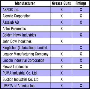

A number of different manufacturers offer grease guns (see Table 1 and contact information), and grease guns are manufactured for a number of different applications. The most common styles of grease guns include the lever, pistol-grip, hand-grip, air-powered and battery-powered styles.

Grease Gun Manufacturers
Table 1

Manufacturer Contact Information
ABNOX Ltd.
Langackerstrasse 25
Postfach 81
6330 Cham
Switzerland
phone: +41-41-780-4455
fax: +41-41-780-4450
e-mail: info@abnox.com
www.abnox.ch
Alemite Corporation
7845 Little Ave.
Charlotte, NC 28226
phone: 704-542-6900
fax: 704-542-6591
e-mail: comments@alemite.com
www.alemite.com
Assalub AB
P.O. Box 240
SE-597 26 Åtvidaberg, Sweden
phone: +46-120-35840
fax: +46-120-15211
e-mail: info@assalub.com
www.assalub.com
Astro Pneumatic
18051 E. Arenth
City of Industry, CA 94718
phone: 800-221-9705
Golden Hawk Industries
C.A.MEJIA & CIA S.A.
Carrera 48 # 14-160
Medellin, Colombia
South America
phone: 57-4-266-6767
fax: 57-4-266-4282
e-mail: iarango@camejia.com
www.lubricom.com
John Dow Industries
151 Snyder Ave.
Barberton, OH 44203
phone: 800-433-0708
fax: 330-753-6419
www.johndow.com
Kingfisher (Lubrication) Limited
136 Meanwood Road Leeds
LS7 2BT England
phone: +44-113-209-8989
fax: +44-113-237-4027
www.kingfisherlub.co.uk
Legacy Manufacturing Company
6281 North Gateway Drive
Marion, IA 52302
phone: 800-645-8258
fax: 319-373-7309
www.legacymfg.com
Lincoln Industrial Corporation
One Lincoln Way
St. Louis, MO 63120
phone: 314-679-4200
fax: 314-679-4359
www.lincolnindustrial.com
Plews/ Edelmann/ Lubrimatic
Route 38 East
Airport Industrial Park
Dixon, IL 61021
phone: 815-288-3344
www.lubrimatic.com
PUMA Industries, Inc.
1992 Airways BIvd.
Memphis, TN 38114
phone: 901-744-7979
fax: 901-744-7579
e-mail: sales@pumaaircenter.com
Suction Industrial Co., Ltd.
No. 245, Ton-Pin Road
Taipin City, Hsien
Taiwan
phone: 886-4-2270-0858
fax: 886-4-2270-2678
e-mail: suction@iplus.net.tw
UMETA of America Inc.
114 East Bend Court, Suite 4
Mooresville, NC 28117
phone: 740-799-1840
fax: 704-799-1923
www.umeta.de
