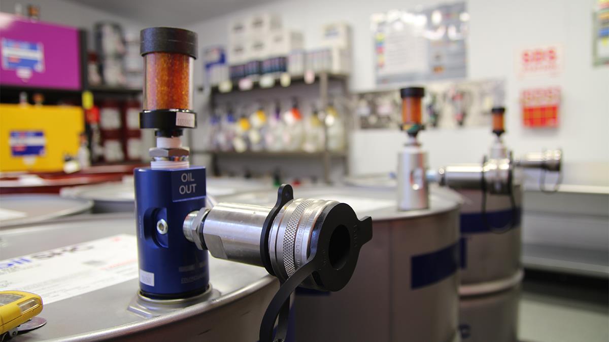

It starts with keeping your lubricants clean, cool, dry, and clearly labeled. That means a clean, orderly and organized lube room. That means sealed, climate-controlled storage. That means using tools like filter carts and dedicated transfer containers (not that old coffee can) to keep oil clean even during transfer.
Once at the asset, you apply lubricants based on hard data like OEM specs or oil analysis—not gut feel. You apply them with calibrated tools using a purposeful process. You document quantities and intervals.
And when you really dial it in, the entire team knows what lubricant goes where, how often, and why it matters. Eventually, it becomes second nature—like checking the oil in your car before a road trip.
