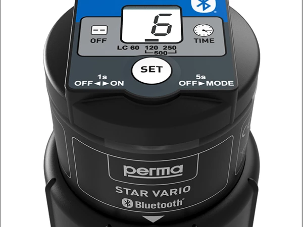

perma STAR VARIO operates fully automatically, independent of temperature and pressure with a very precise discharge. The system consists of an electromechanical drive, an LC with 60, 120, 250 or 500 cc of lubricant, and a battery pack.

The perma STAR VARIO BLUETOOTH offers realtime configuration, control and maintenance from a distance via the perma CONNECT app.
The perma STAR VARIO LONG RANGE uses LoRa® wireless technology to manage up to 2,000 lubrication systems per gateway over a distance of up to 2 km.
Automatic single-point lubricators are particularly effective for critical assets, inaccessible or hazardous lubrication points, and applications where consistent grease volume and interval are difficult to achieve manually. Solutions such as perma’s Bluetooth and Long Range single-point lubricators take this approach to the next level by adding remote monitoring, adjustment, and visibility into lubrication performance. These capabilities enable maintenance teams to manage lubrication more proactively, reduce manual intervention, and further standardize best practices across the plant without sacrificing precision.
