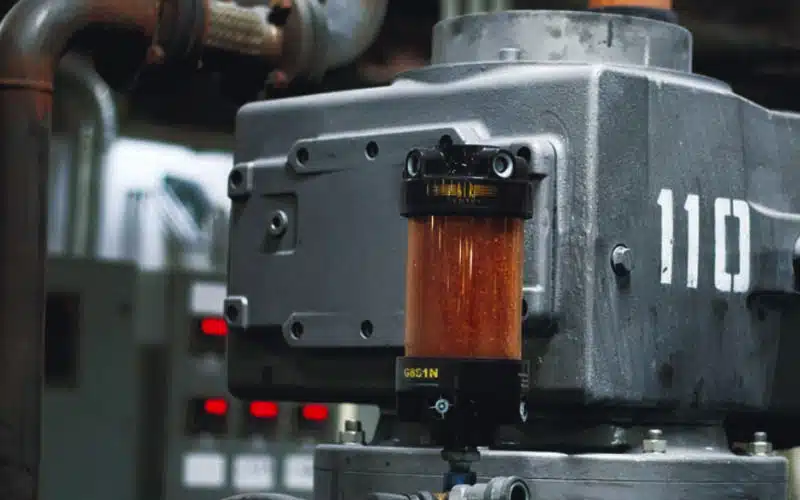

Contamination Control
Air Sentry desiccant breathers effectively reduce particulate and moisture contamination
KPIs for contamination control are among the most important metrics for lubrication excellence. They should be focused on the strategy implemented to keep contaminants away from the in-service lubricant.
Examples of these KPIs would be the cleanliness target compliance by machine type, the humidity limit compliance by machine type, the temperature limit compliance by machine type, the compliance of varnish potential limits by machine type, and the progress in the implementation of machine modifications such as desiccant breathers to control contamination levels in the in-service oil.

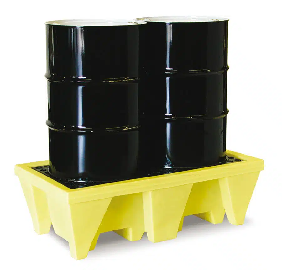

Lubricant Disposal, Leaks and Spill Management
OilSafe Spill Pallets are designed to improve workplace safety and eliminate incidental spills.
These metrics refer to all the procedures used to ensure proper disposal of lubricants and contaminated materials. They may also focus on lubricant spill and leak management.
Examples would include the percentage of lubricants disposed of relative to the number of lubricants purchased, the amount of lubricant-contaminated materials disposed of, the consumption of spill-containment material, the volume or cost of lubricant leaks, and compliance with the ecological disposal training plan.
