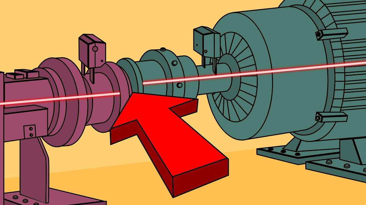

Laser Alignment
Laser alignment makes it easy to align shafts with precision and accuracy. It works by projecting a laser into a sensor, which then feeds data to a device that calculates the necessary adjustments. Once the laser and sensor are mounted on the driver and driven machines, the shafts are rotated and multiple readings are taken to determine the necessary corrections.
Modern laser alignment tools can also account for the equipment’s metallurgy and offer compensation for thermal growth. Some systems allow for “live alignment,” where the technician performs initial alignment, starts the machine to operating temperature, then shuts it down for final measurements to assess thermal expansion effects.
While laser alignment is highly accurate and beneficial for critical equipment, it requires a shutdown and dedicated maintenance time. For equipment that operates on shorter cycles, alternative detection methods may be more practical.
