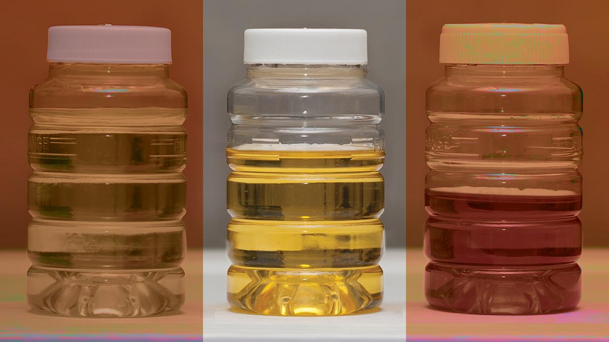

A comprehensive study was conducted on 67 oil samples from an Austrian steel producer to better understand the effectiveness of different oil monitoring methods. These samples included fresh industrial lubricants, artificially aged oils, and oils that had been in service for some time.
The study aimed to compare various techniques used in oil condition monitoring. The oils tested ranged from engine oils to hydraulic and gear oils, covering both traditional mineral-oil-based lubricants and modern synthetic alternatives.
The Sample Matrix
  • Fresh Oils: 9 different fresh lubricants were chosen as the starting point.
  • Artificially Aged Oils: These fresh oils were aged under controlled conditions to simulate long-term use, resulting in 3 to 4 aged samples per fresh oil type.
  • In-Service Oils: Samples of oils already used in machinery were also collected.
Sixty-seven samples were analyzed, allowing for a thorough comparison of how different oils perform over time and under various conditions.
