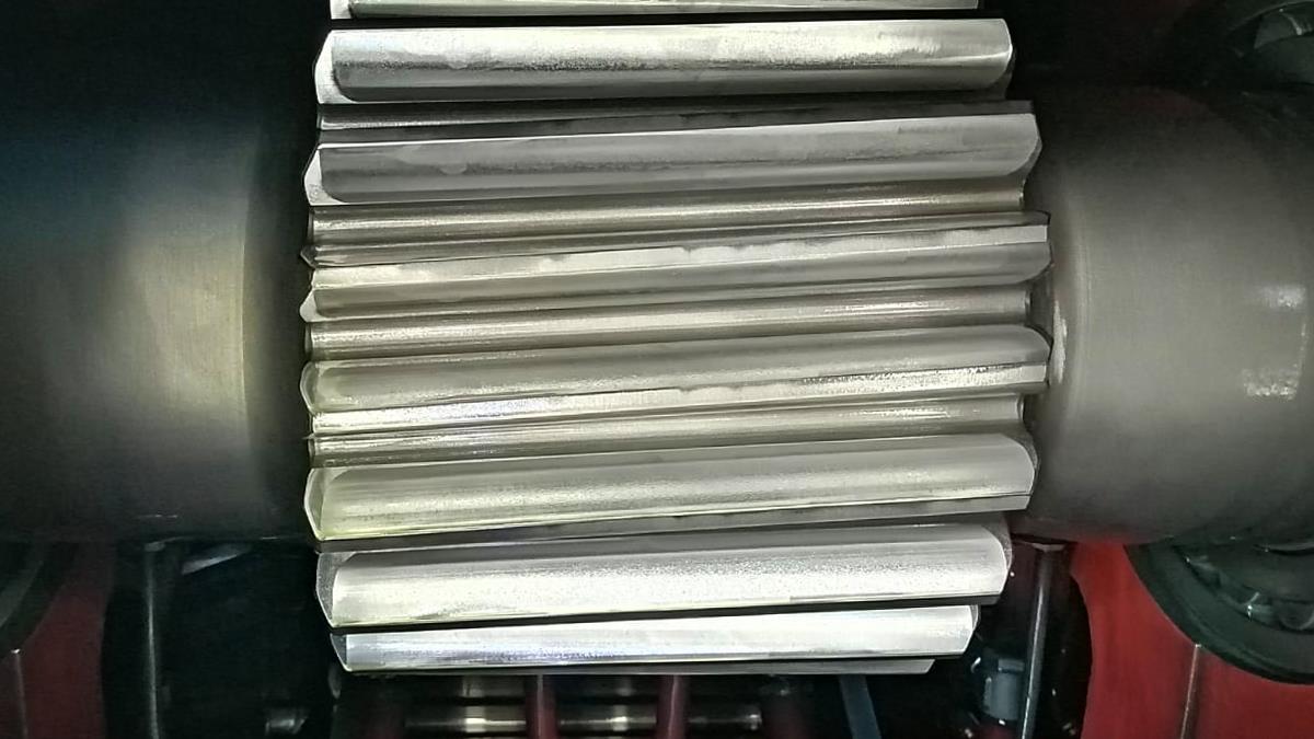

We were tasked with overhauling the main drive gearbox at this particular cement mill. One month after these actions were taken, we began observing an abnormally increased vibration tendency. To discover the root cause, we started by reviewing gearbox specifications and history.

About a month after the overhaul, we once again began seeing an abnormal increase in vibration tendencies. We decided to stop mill operations to allow gearbox inspections, where we observed dust particles in the oil.
Obvious Oil Contamination Prior to Oil Change
While oil sampling was performed every 90 days, we took two additional samples over the course of a week to verify the oil condition. The lab results confirmed what we had observed—the oil was contaminated, and the contamination was increasing steadily.
An oil replacement was immediately conducted on the 5,000-liter tank. During this process, we cleaned the gearbox sumps, oil tanks, and duplex oil filter housing and replaced the oil filters. Additionally, a detailed inspection was performed on the lubrication circuit’s sealing system, which revealed that a small part of the dust seal was damaged, allowing contaminants to enter the lubrication system. This dust seal was immediately repaired.
