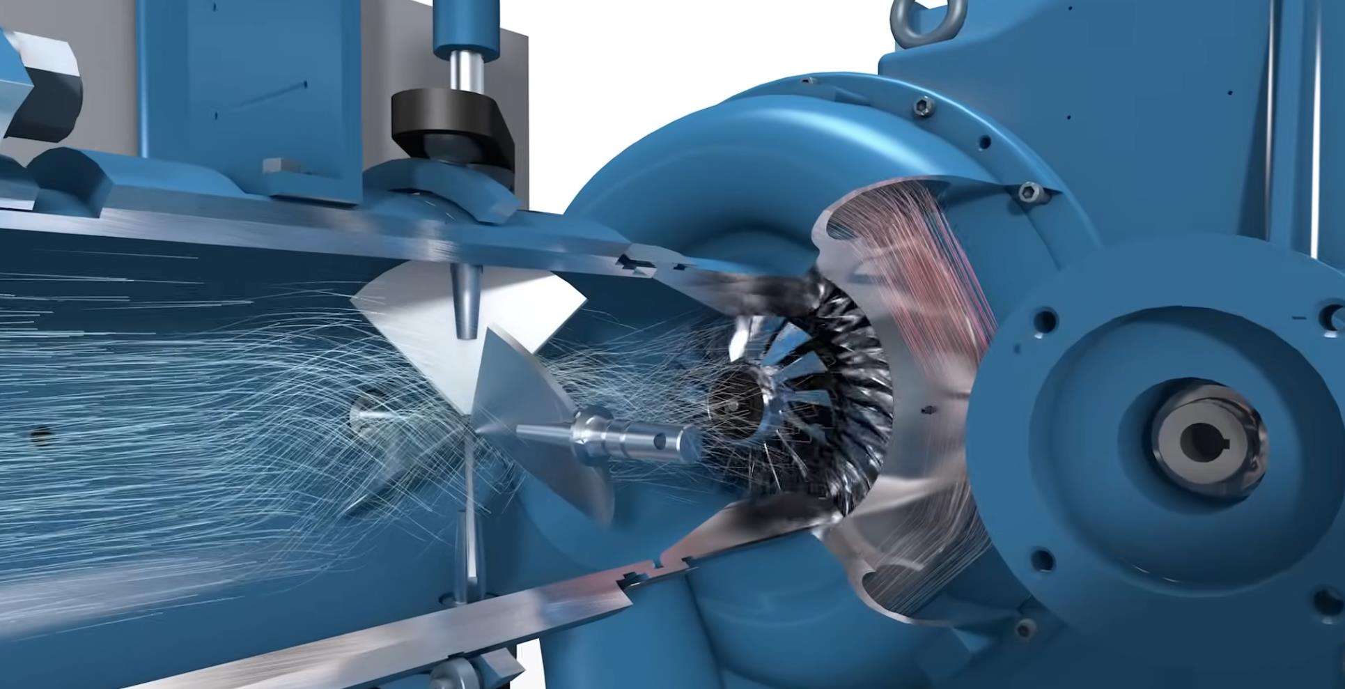

Integrally geared centrifugal air compressors are multi-shaft machines used worldwide to provide high volume, high-pressure air for essential plant functions. These compressors use a central bull gear to drive one or more pinion shafts, each equipped with one or two impellers per compression stage. These compressors can span many applications across oil and gas, petrochemical, air separation and other industries.
In an integrally geared centrifugal air compressor, the lubrication requirements must consider both the high-speed rotating elements and the low-speed gear elements. The high-speed pinions can operate at tens of thousands of RPM on hydrodynamic bearings, whereas the bull gear, operating at the motor’s input speed of just a few thousand RPM, must withstand the load transferred from the motor to the pinions. In this case, the lubricant must provide sufficient lubricity to the bearings for smooth operation while also being robust enough to protect the gear mesh between the rotating elements.
Components Geared Air Compressor
Figure 1. Lubricated Components of an Integrally Geared Air Compressor
