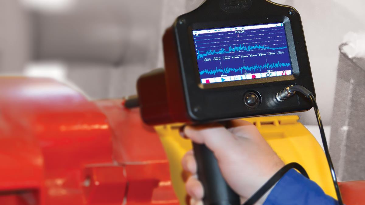

Ultrasonic equipment captures both airborne and structure-borne ultrasound signals that are imperceptible to the human ear. It electronically transposes them into audible signals that a technician can hear through headphones and view as decibel (dB) levels on a display panel. Some instruments can also view the received sound on a spectral analysis screen. With this information, a trained technician can interpret the bearing condition to determine what, if any, corrective action is needed.
Ultrasonic technology helps the lubrication technician eliminate much of the guesswork regarding lubrication needs. Ultrasound is a localized signal, meaning that when a sensing probe is applied to a bearing, crosstalk will not affect it. This allows the technician to hear and monitor the condition of each bearing. Ultrasound looks at each bearing individually, like medical ultrasound can detect which artery is clogged or which vein is leaking.

The first step is establishing a baseline dB level and a sound sample. Ideally, this is done when moving through a route for the first time by comparing dB levels and sound qualities of similar bearings. Anomalies will be easily identified.
Once established, each bearing can be trended for amplitude or sound quality changes over time. Generally speaking, when a bearing's amplitude exceeds 8 dB, and there's no difference in the sound quality established at baseline, the bearing needs to be lubricated. To prevent potentially disastrous over-lubrication, the technician will apply lubrication, a little at a time, until the dB level drops.
Many departments implement a two-stage approach to their condition-based lubrication programs. The reliability inspector uses a relatively sophisticated ultrasound instrument to monitor and trend bearings, producing a report of bearings needing lubrication. The lube technician then uses a specialized ultrasound instrument that alerts the technician when to stop adding grease. These instruments can be affixed to a regular grease gun or worn in a holster.
